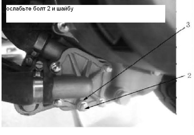

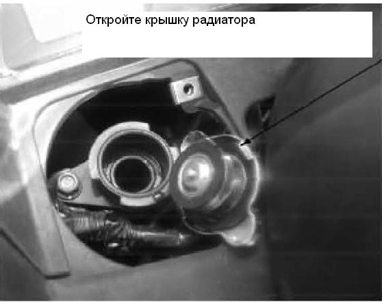

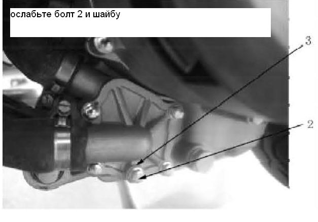

насчет замены полностью.....

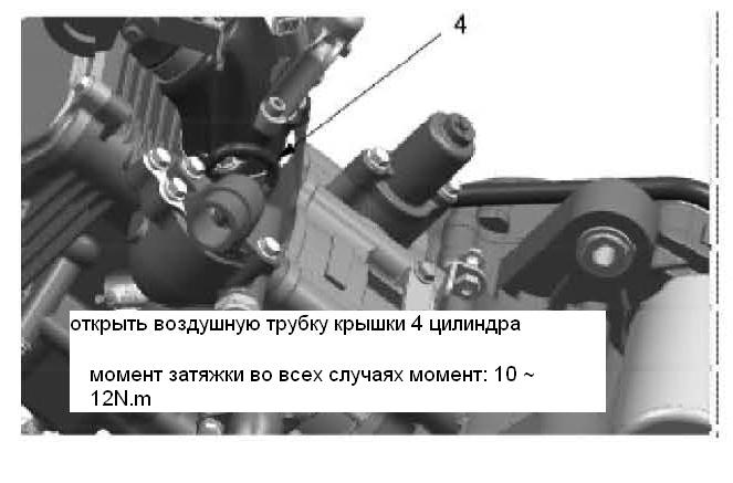

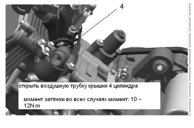

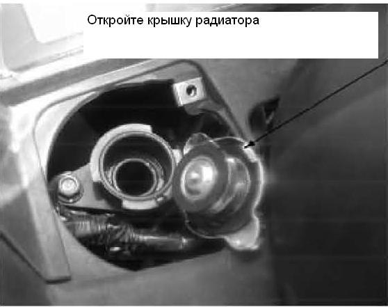

Вот глянь чо в сервис-мануале нарисовано :)
фото ниже.(расположены в обратном порядке)
рядом есть человек прилично владеющий техн.англ?
а то онлайн-переводчики с этим текстом не справляются :)
Change the water tube if raditaor, Coolant tank,clamp is damaged or cooling liquid is leakage. Inspection of enine cooling liquid, inspect the the helight of assistance water box and the line of lower and upper limit, if under the lower limit,add cooling liquid until to the superior limit. Change the engine cooling liquid.
• open the radiator cover 1;
• put one plate under the water pump, loosen the nut of water pump 2 and gacket 3,exhaust the cooling liquid.
Warning:
•Don't open the radiator cover if the engine cooling liquid isn't cooling, otherwise, it is damage for you by the water vapor and scalding cooling liquid, •cooling liquid is poisonous, Don't drink it. also don't stick into skin and eye,Cleaning by water and go toe special hospital in case of any situation. •Take care of cooling liquid, keep in the safely place and kid couldn't catch it.
• clean the radiator by cleanly water.
• Install the nut and gasket of water pump •open the air tube of cylinder cover 4.
Note:the air tube of cylinder cover shoud turnon one side of outlet tube.
• fill the cooling liquid for engine from the filler of radiator.meanwhile,observe the air tube of cylinder, assemble the air tube of cylinder if withou air erupt, fasten thecover when cooling liquid is full.
jnoperate the engine for few minutes,then,stop working,inspect whether it is enough of cooling liquid when engine cooling and open the radiator, if not,fill cooling liquid again, repeat the process by several times. Insure that without air in cooling liquid of radiator. Inspect the cooling liquid of assistance water box. the liquid level whether it is between the superior and lower limit, insure the liquid lever between the superior and lowr limit, warning :
Don't mixed it with other cooling liquid. Torque:10~12N.m accessories:cooling liquid of engine. Tool: socket spanner 8,wessel
полегчало? :-D
4.JPG [ 36.44 KiB | Просмотров: 4173 ]
2.JPG [ 25.42 KiB | Просмотров: 4173 ]
1.JPG [ 26.91 KiB | Просмотров: 4173 ]
АЮ
Последний раз редактировалось Aleko 01 Jul 2014, 23:46, всего редактировалось 1 раз.

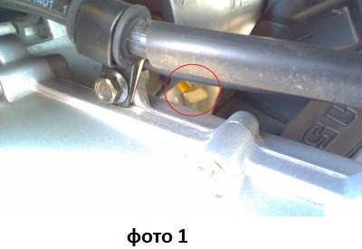

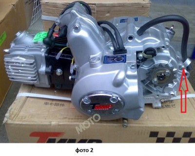

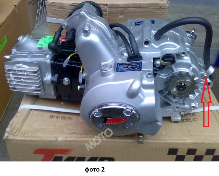

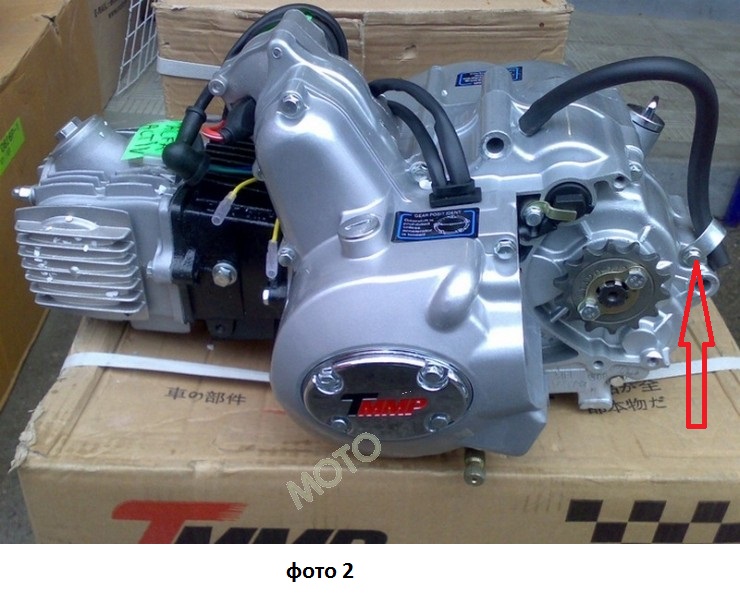

Так кто нибудь ответит зачем трубка под колесом ? ФОТО 1. Точнее зачем, полазив по инету я вроде разобрался. Это на вроде сброса картерных газов как на ФОТО 2. Но везде где нашел инфу по этой трубке, она просто выходит на улицу и всё. Наша же трубка запаяна на конце. Т.Е. с улицей не связана и значит давление в картере двигателя не скинет ?
205373.jpeg [ 130.55 KiB | Просмотров: 4198 ]
IMAG0134.jpg [ 27.78 KiB | Просмотров: 4198 ]

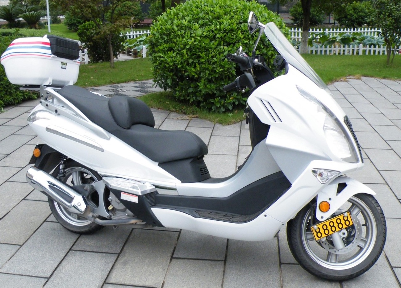

еще раз о переднем номере:
на западе видать в обязаловку его иметь и ставить(см.фото)
